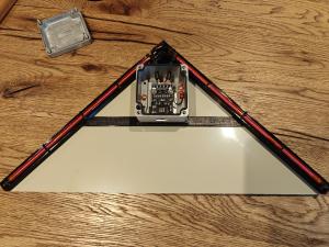

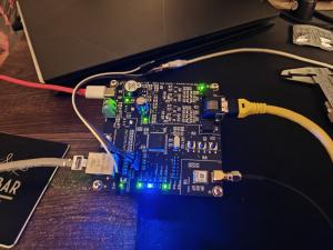

Here are some images of the controller, and H-Field I built It goes to show that anyone can do it from scratch with the information available!
