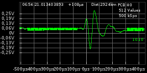

In order to register a stroke, both H-field antennas must sense it above the thresholds.
I see many signals here --that are obviously lightning-- that are not registered as a stroke for that reason. Only red, or only green, (and not both) pick it up the signal.
And it does not matter what any third H antenna (mine is a loop parallel with the earth) OR what the E-field antenna receives.
BOTH H-field antennas must sense it! Otherwise, it will only be a signal, and not a stroke. Some of the most successful stations in region 3 only have two H-field antennas.
(Note that stations with one H and one E antenna all have negative efficiencies! And there are many of them.)

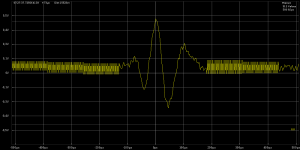

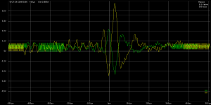

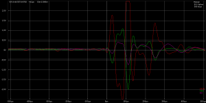

@mwaters,
I tend to disagree with your statement. If the two H antennas are oriented at 90 degrees and one sferic arrives that gives a maximum signal in one channel, then the signal in the other, perpendicular channel would be zero, but a stroke should be registered. Just at the moment, my station is receiving a lot of signals from a direction such that only one H channel gets a signal, and looking in the list of registered strokes a lot turn up with only one H channel. Just have a look at the image below.
Of course there are others (second image), where all channels are involved, but both H channels are not required.

Hi Pasense, I agree, I had my station, whilst I was in the initial set up, with only the "E" field functioning. I also set up the "H" channels individually.
I was still registering strokes and was able to optimise each channel, without the confusing array of squiggly lines that are present, when all the channels are activated at once.
Having said that, whilst in your first example, the Green signal is very clean and well defined, in your second example you have far too much gain!
The Red channel is flat topped and chopped and even the Green and Magenta channels have signs of distortion products.
Even in low noise situations, I believe that gains over 10 are very rarely needed and for signals within 2,000 km range, gains of 8*5 or even 5*5 will produce excellent results.
Reducing the gain actually makes the system more sensitive, because you are not amplifying the noise floor as much and therefore have a better signal to noise ratio.
I have made this suggestion to several stations now and they will confirm that their stroke rates and their locating rates are now much more efficient and their effectivity is more constant.
I know that you are in a special situation due to your location, but I would like to suggest that you try this for a few days and compare the results between various levels of lower gain and higher threshold levels.
You may be surprised and if not, it is only the matter of a few seconds to return to your present settings.

Brian,
you are right, the signals go in saturation for these strokes, but these were actually the strongest signals I have seen so far, so I copied the signal traces. I am just experimenting in order to see if and how I can get also polarity information from strokes over the ocean (which is supposed to be difficult or impossible), but yes, I could reduced the gain of the H channels. Coming back to useful plots we would like to have: a histogram of maximum signal strength, both for signals sent and for signals used in strokes would make it easy to spot such situations: these would just go into the "overflow" bin. So far, I have to look at the list of strokes in order to find out if the amplification and thresholds are OK. Such histograms are standard in all situations where one has to adjust such parameters and I am sorely missing these here!
