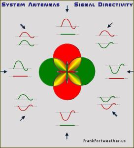

Yes, if two loops are phased correctly, and at right angles, and both signals can be viewed at the same time, it is possible, theoretically, to get at least a 'rough' azimuth by comparing the signals... Yes, there will be 'signal phase' differences between each loop, depending upon direction the signal cuts the loops.  This is NOT true for a single E field Probe, which is omnidirectional.
Some time ago, Richo, one of the developers, loaded a diagram on this forum, which I modified for my own use, Rolleyes which illustrates this.... attached.... this is basically a 'DF" (direction finding) technique, as opposed to a 'locating' technique.

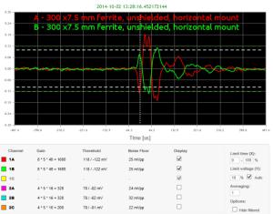

Thus the Noise Signal in the third image would be sourced generally SW, assuming the antennas were NS/EW oriented...

(2016-01-30, 09:38)Cutty Wrote: Hi Bill...
