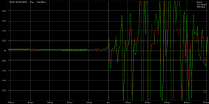

I saw a few close strikes near my station the other night, I think one was around 15 kilometres (9.3 miles). This signal was 25km away and caused clipping, but surprisingly it was still used.
