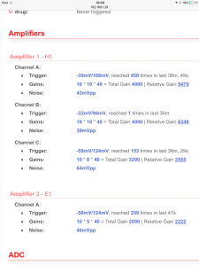

I'm struggling for two days by moving the antenna in order to reduce the number of received signal ... today I accidentally discovered that even without the antenna receiving the same number of signals?!
Station 1701, system blue, two ferrite antennas.

First, you have a large noisemaker which looks like power line noise on the E channel... 10*5 is very high gain ... the E channel is very sensitive. Reduce that channel.
Triggering on E is also allowing a few lower-level H channel noise impulses on H.  There are a few noises impulses getting in H channel at times, but I saw nothing that unusual when I watched your signals a while ago... Fix the E channel noise, and go from there.  If you're operating in automatic, go to manual mode.

I would go to manual mode, turn the gains all the way down on E channel. Then start turning them up until you start getting too much noise, then back off.
To get to manual mode, go to Settings tab.
Under Main go to Remote Control and change the drop down menu to Manual and click apply.
The go to Settings again and AMP 2.
Try gain of 1 and 1.
Slowly increase the gain as needed, 2 and 1, 4 and 1, etc... until the noise is too high.
Consider them multipliers, 1x1 is 1, 4x1 is 4, 5x2 is 10.
Then select a lower gain on first number and increase the second number.
Maybe reverse them.
Find the best combination.
For me it was 5x10, but I am also using filters that I installed.
