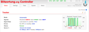

How do we do that (as in re-assign the station to our account)? I cannot see my own station either, 2316. I no longer have a link on the controller page.
Status page looks good, I have placed antennas this afternoon, so the whole system is up now.
Best,
I have tried to remove the station, but now I'm told I'm using a guest account and cannot modify it, never mind assign a station. If I click on the link on the Controller page (it's gone back to "create an account" with the link) I'm asked to create a new account on lightningmaps.org.
Any ideas?
Login in the blitzortung user's area with the accout you created: http://en.blitzortung.org/login.php
Scroll down to "Assign a new station (Processor-ID)" and enter the processor ID you can find on the crontroller status page.
Click save.
If it does not work, you may try to create a new account following the link on the controller page.
Lightningmaps and blitzortung share the same database, thus you can create your account on this website.

Thanks for that - I have used the "Device-ID" field from the Controller page, and it has now re-registered under my account. Next question is, how long does it take for the station to appear in the station list, or the stats to show up on lightningmaps.org? It's currently as if the station does not exist.
