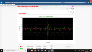

I am pretty sure I have been getting interference from an electric fence. It was only abut 20M away from my antennas but has now been moved further away. I have set the gains right down but now hardly ever pick up lightning. Maybe better than swamping the servers with useless signals.
So A) can anyone identify the trace below as really being the fence and B) would direct earthing of the H field shields help. Or any other tips for that matter.

(2019-06-03, 19:32)Alanpenwith Wrote: So A) can anyone identify the trace below as really being the fence and B) would direct earthing of the H field shields help. Or any other tips for that matter.
I don't think either of the signals are an electric fence. The small regular and alternate polarity ones are at about 10 kHz, fences tend to pulse at 1 Hz or less. The signal in the middle doesn't have the amplitude that I'd expect from a fence only a few tens of metres away.
