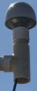

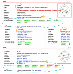

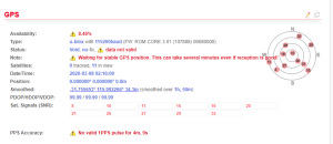

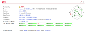

Thanks mate. I did a cold reboot as you said and left it overnight. GPS kicked in but now no reception. I guess its because of where I live.
I've attached screenshots and a pi of the antenna I'm using.

the photo of the gps there is that got a bnc plug ?was it of marine use ?

That is fairly old GPS firmware.
Mine is at Mediatek with 115200baud (FW: AXN_3.8_3333_16072100,8397)
You might want to try and upgrade.
There has also been posts about GPS week number roll-over issues. A firmware might or might not fix this. There are posts on this forum how to do the firmware upgrade.
