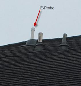

This is what I did for my E-Probe. I installed a dummy 2" vent with a cap near the top of the rood. It sticks out about 12" above the roof line
From inside the attic.
I mounted the amplifier to a shortened 3/4" cap, put the coax inside the 3/4" pipe, screwed the end to the amplifier and place the cap on the pipe. The pipe is just long enough, so the probe wire does not touch the outside cap.
.jpg   E-Connected.jpg (Size: 24.85 KB / Downloads: 119)
I now place the 3/4" pipe inside the 2" and it rests on a screw at the bottom. (see picture 2)
This keeps it safe, dry and easily reachable. No going up and down the roof.
