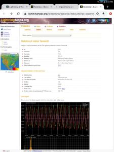

I sincerely hope that was not really your station picking up that awful noise. Something needs fixing on your page here; it links to this one. You should ask to have that fixed in this thread.
Looks to me that the inverter has a switching frequency between 15 and 20 kHz, smack dab on the fundamental frequency of many lightning strokes.  Sad
