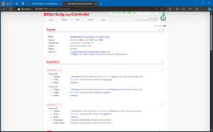

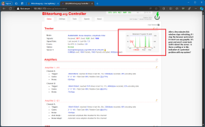

I've noticed that on my controller's Status Page there is a graphic showing Received/ % good/ % sent over Minute/Hour/Day.
I find this very useful to see if I'm getting hits and the system is working.
I notice that after a few minutes this graphic stops updating.
If I restart my web browser (any browser) after it stops updating it actually doesn't show up.
The only way I can get the graphic back is to reboot the controller.

I have noticed the same behavior with both of my Blues.  One is Rev 19.3 and the other 19.5.  Both live graphics on the Status tab dissappear even though the controllers continue to operate normally  The Live Signals tab continues to update normally.  I want to say the issue has been worse since firmware 10.x but have not actually tried to troubleshoot too much.  Both are running 10.0b2.   A reboot of the controller does resolve the issue.  Have tried Chrome and Edge (Windows 10) and clearing cache etc. but only sure fix is controller reboot.
