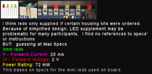

I'm not sure it's actually feasible for many folks... I wouldn't fool with it, myself on a Mini/Basic... The Blue Mini doesn't appear to have the solder pads for external leds.  Blue Max did, and many have installed the LEDs ... some came with the earlier kits.

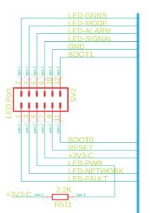

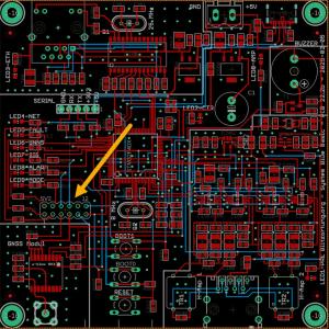

I had look at the Mini boards as posted by Egon. It looks like he did some modifications to the layout and added a header to connect external leds on the 22b boards.
I do not have a mini, but it looks like the spacing is such that you can solder a pin header in there and then use a ribbon connector to plug in. The other end can the be connected to Leds. Yes, I will not solder directly to the board, but use a header.
The header does provide both +3.3v  with a load resister and gnd. See schematic.
I would use the lowest current draw led's I can get, as normally each led has it own load resister.
Dries

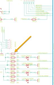

Digging deeper into the schematic, I do notice there is already provision made for a 1K load resistor per individual LED. I dont know if the board comes with the resistors pre-installed, but they are 0603 SMD's, so not to difficult to solder on if not already there.
It appear the 2.2k resistor is for the Power On led going to pin 5.
I would be very careful not to short pin 7 (+3V3-C) to ground.

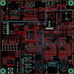

Seeing those images of controller 3410, a v22.2 board, which is what I was referring to originally, I see no header, and no designed provision for 'external' leds. I go back to my initial response, in this situation, " I'm not sure it's actually feasible for many folks... I wouldn't fool with it, myself on a Mini/Basic... The Blue Mini doesn't appear to have the solder pads for external leds." Remember Mini is designed to be as simple and low cost as possible. No bells, whistles, no e field, no auxiliary signal outputs or variable digital low pass filter options, even the switchable High Pass amplifier stages are removed, and additional gain (15?) added to preamplifier to compensate in this basic version. Sure, this one could be 'worked around', with background and skills, etc.,  but, for this production version,  I think this is more in the tone of J.P. Morgan's response to maintaining a yacht:  "If you have to ask the cost , you can't afford it".
Yes, I agree with Cutty, unfortunately this is Revision 1 of the Blue Mini with no provision made for extending the LED's to the front panel.
