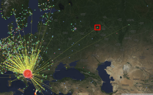

Also, I would like to note that on the Blitzortung online map I can see the yellow tracers from my station to the lightning strikes, as well as the timely update of the 'Last Signal:' status. This shows that the signals do reach the server, but for some reason they are not updating on the online panel
PS: There are no errors in the debug logs related to the internet connection, so that should be fine
