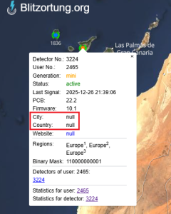

Receiver situation
Where do I configure the city and country settings on my receiver?
Thank you very much!
https://www.blitzortung.org/login.php
You can update your personal info here.  NOTE: "Anonyn" means exactly that. IF you 'Y' you will NOT be visible to public, maps, etc.  Suggest leave it 'N'.
Scroll down
Your station info is below that 'profile' info, You should enter your antenna configurations while there.
You also enter the city, country, etc for that specific station,...again, "Anonyn" 'Y' means that station WON'T be visible. Suggest leave it 'N'. then scroll down past the 'last signal' images, and click "save"
Now that your GPS problem is solved, there is another little detail to update
antenna description in the settings, this will help the servers to decode your signal
this is mine
and yours
the settings part
