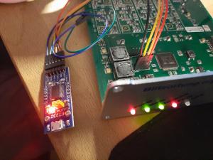

I make a short post to explain what happened to me recently. I bought a second hand station with programmed network parameters which were not suited to my network.  The consequence qas a steadily blinking network LED. I was not able to understand the underlying problem... because you need access to the embedded html server of the blue system in order to make a nice and easy diagnostic.
I then had a look at the forum and I could not find any hints, I then started on my own trying things. I resolved the problem (on linux but on windows it would be the same) by connecting a Serial to USB adaptator, see pic below.
I then tried with the moserial software to understand the message delivered by the blue system, to this end I had to adapt the communication speed between my computer and the blue system (config file for the moserial software is also attached to this post). I used a FT232 adapter from waveshare configured in 3.3 V.

I could then read the message provided by the blue system during the initialization phase (after reseting the system), see an exemplary copy of it:
2013-01-01 00:20:06 1050.2 | === Network static config is: ===
2013-01-01 00:20:06 1050.2 | IP:      192.168.50.235
2013-01-01 00:20:06 1050.2 | Netmask:  255.255.255.0
2013-01-01 00:20:06 1050.2 | Gateway:  192.168.50.1
2013-01-01 00:20:06 1050.2 | DNS:      8.8.8.8
2013-01-01 00:20:06 1050.2 | DHCP:    off
2013-01-01 00:20:06 1050.2 | MAC:      xx:xx:xx:xx:xx:xx
2013-01-01 00:20:06 1050.2 | MTU:      1480
2013-01-01 00:20:06 1050.2 | EVENT: Network is UP
This message showed me clearly that the system was looking for the wrong local network address, I had to change my local network address in order to fulfill the requirement of the blue system. Using this approach I could connect to my Blitzortung box though the router and reconfigure it properly. I switched on the DHCP and then I could manage having everything working.

Elektrofeldmeter, well done indeed at how you found and fixed the IP Address issue.
Not to minimize your efforts, but if you posted that you bought a controller from someone else and cant get into the system, I could have PM'd you how to factory reset it. This will wipe out the previous username/password, set the default IP address and turn DHCP on, etc.
