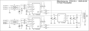

Is your preamp the 23.1?  If so, see the schematic:
The signals from the antennae smack immediately into a substantial diode chip.  It absorbs everything in excess of maybe 1.4 volts.   So there is no danger of your damaging the preamp.
Thanks for the schematic!
Where did you find it? I looked around for it and didn't find it right away.

(2025-08-11, 01:40)oppedahl Wrote: [quote pid="27250" dateline="1753345722"]
Can you tell me what J1 and J2 are for?
[/quote]
See this discussion.  Apparently you leave them open if you are using ferrites and close them if you are using air core loops.
