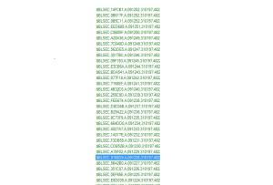

but the GPS Data looks good:
(see attachment)
Any ideas ?
Edit: I noticed that the date from the GPS seems to be wrong indeed: 31.01.1997 (why that??)

Hi folks i fixed it myself. It was a wrong dateformat setting wthin the gps .. I dont know why but it works fine after i set it to the correct time date format.
