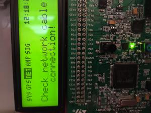

After 18 minutes , all ok , look the photo.
tks

after ten minutes, on the display: Check network cable connection... networks down...

Tobi, its OK now, after 30 minutes with network down without touching anything, its OK !!!
